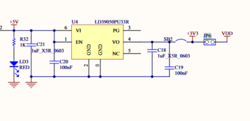

2018-02-26 10:11 AM
The schematic shows these details:

2018-02-26 10:18 AM
This would be bad design....
2018-02-26 10:22 AM
3.3V is used for st-link, VDD for target MCU. The current flows from 3.3V toward VDD through JP6, and finally to the target MCU.
