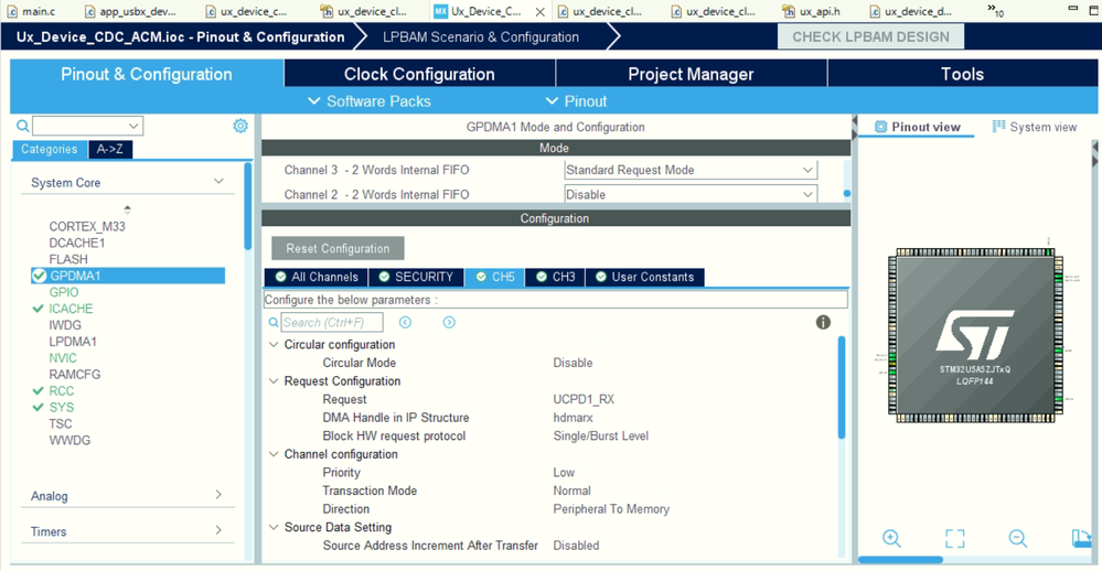

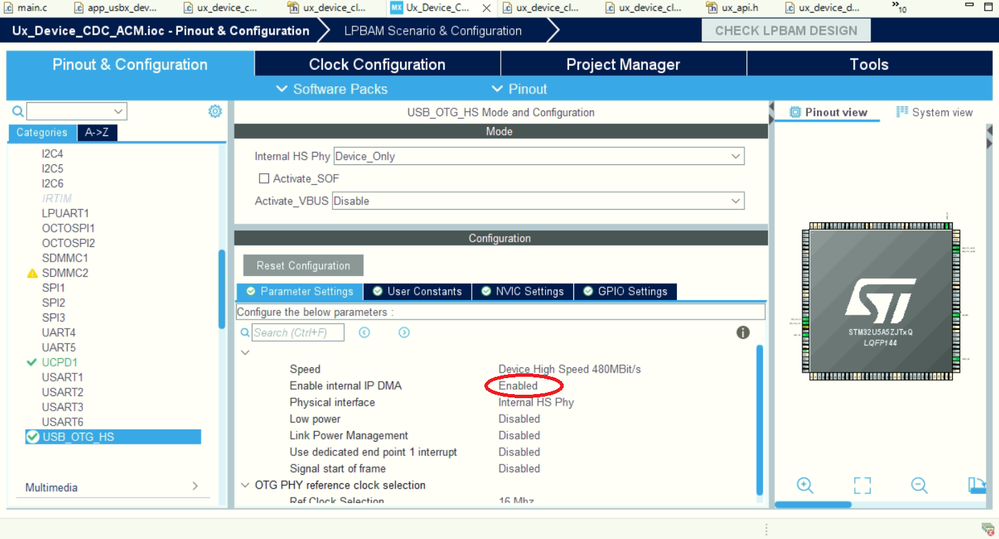

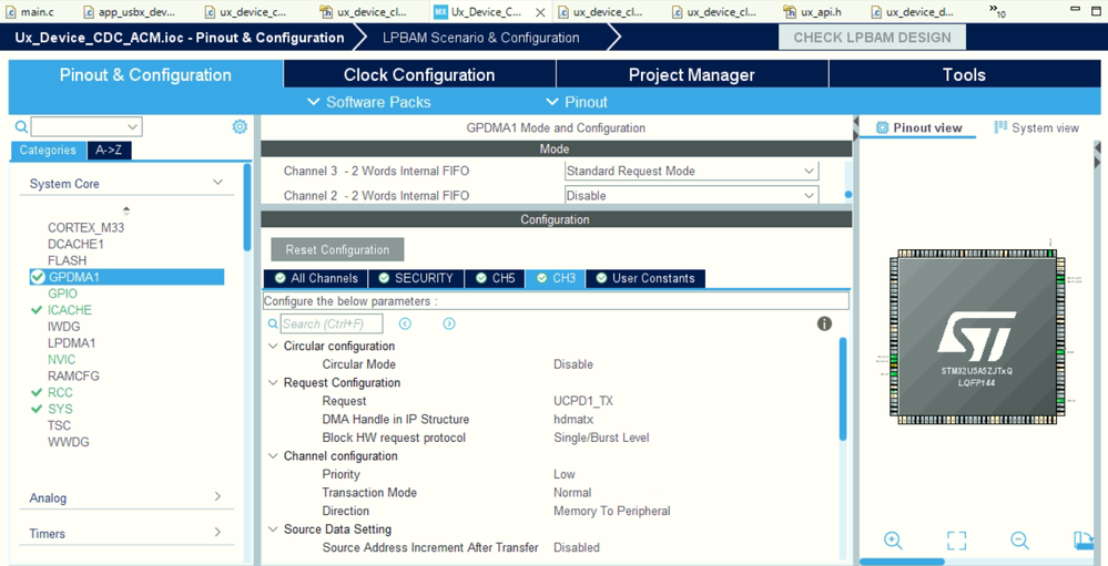

@FBL Thanks for the reply. I have managed the hard fault handler issue in my code and now the ux_device_class_cdc_acm_write_with_callback API in non-blocking mode works successfully. But the speed is now reduced to 3 MBPS from 5 MBPS of the blocking mode API.
I have also tried by enabling the internal IP DMA in the configuration. Below attaching the screenshots of ioc configuration for DMA. The GPDMA configuration was already from the example project.
DMA enable
DMA Rx channel
DMA Tx channel
After enabling the DMA in ioc, the write function _ux_dcd_stm32_transfer_request failed to send the data over USB and it is waiting for a semaphore,
/* We should wait for the semaphore to wake us up. */
status = _ux_utility_semaphore_get(&transfer_request -> ux_slave_transfer_request_semaphore,
(ULONG)transfer_request -> ux_slave_transfer_request_timeout);So, My doubt is that, Is there any other configurations need to be done for working of the internal DMA? So this where I stuck in DMA configuration.
