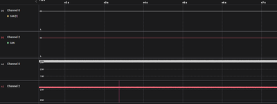

i have a question about the stm32h723. I tried setting up the CAN peripheral and it's not working. I absolutely don't know why. Can anybody help me out please?

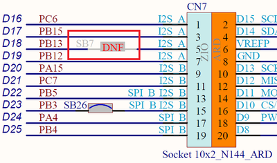

According to the schematics, I think you are probing PB13 (CAN_TX) on CN7/5 which is not connected by default to PB13 as SB7 is not soldered by default. That's why it's important to check the schematics before suspecting any issue in the software:
So probe on CN12/30 instead.
I modified your project (main.c in attachement), your "x" variable used for Tx has no sense. RxFIFO0 is also triggered and I can see Tx frames on PB13 on CN12/30.
Hope it helps.
