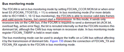

As I can see from your code, you are using Bus monitoring mode:
hfdcan2.Init.Mode = FDCAN_MODE_BUS_MONITORING;
According to the reference manual, in this mode FDCAN cannot start a transmission.
So try to use Loop back mode (Internal or External)
2024-07-18 1:18 AM
Hello @floppy and welcome to the community,

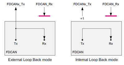

2024-07-19 12:46 AM
Hello SofLit,
thanks for your help.
That was my mistake, I tried to toggle the TX pin, so the bus monitoring mode was still in the programm code.
In both external and internal loopback mode, I receive the sent blocks, but I see no behaviour on the external TX pin. I am using Pin PB12 and PB13.
2024-07-19 1:17 AM
Hello floppy,
You can see the sent frames on Tx pin only in External loopback mode.

But you still using Normal mode:
instead of External loopback mode:

2024-07-19 1:53 AM - edited 2024-07-19 1:53 AM
You can't use Normal mode if there was no CAN bus established and was another CAN node connected to it.
So keep external loopback mode for the moment.
As per you previous comment "In both external and internal loopback mode, I receive the sent blocks, but I see no behaviour on the external TX pin. I am using Pin PB12 and PB13."
So please attach a project with external loopback mode where you can send/receive correct data but you can't see Tx frames using an oscilloscope.
