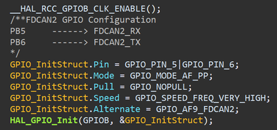

Works for me. Here's the pin initialization code it generated:
You're not on the latest STM32CubeIDE version. Could be that. Could also be misreading something.

2024-08-20 6:33 AM
