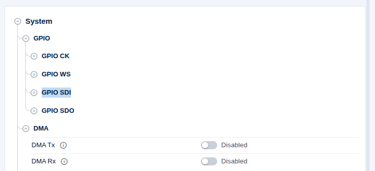

e.g. select I2S with "Master transmit" which should only use I2S_CK, I2S_WS and I2S_SDO, yet the I2S_SDI pin is also muxed and blocked for other use (and both DMA directions are available)

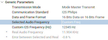

with old CubeMX, one could select a custom sample rate:
new CubeMX2 only provides a fixed list, it should also allow a user defined sample rate

Hello @av500
Audio codec in the market use only frequencies that are listed in CubeMX2. Provide other frequencies does not really make sense according to existing devices.

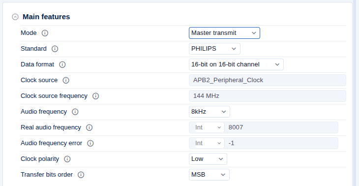

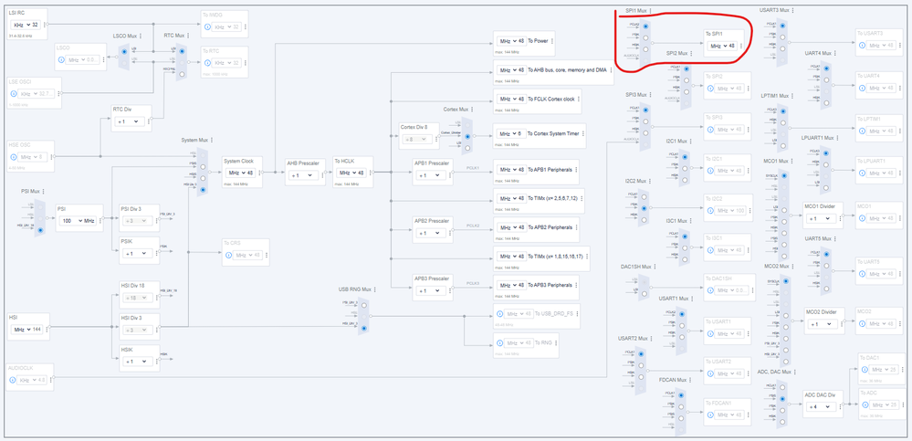

If the purpose is to fine tune the real frequency on I2S bus, then the user can change in the clock tree the source clock frequency of his instance. The real frequency depends directly on this source clock and the computed prescalers. For instance, to reach 11kHZ on C5 product he can choose PSIK as source clock configured at 100MHz and the real frequency will be 11042Hz :
It is also possible to choose APB2 as source clock at 48MHz, then the real frequency will be 11029Hz :
This fine tune step must be done inside clock configuration panel :
If possible, please tell us your specific requirements, and we’ll provide the correct setup for your clock.
