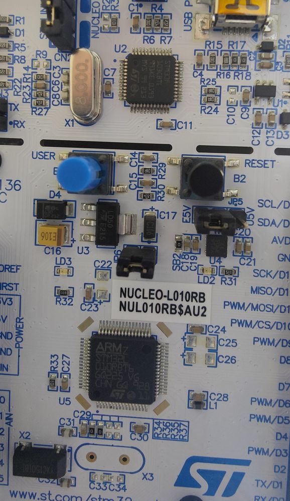

I buy a new board L010RB, but it is labelled with classic strap "NUCLEO-L010RB" but there is one line after with is "NUL010RB$AU2". I had a couple of L010RB before but it's the first time i have such label on it.
I'm wondering what is mean.

Ok for the product order code. By looking the left box of my others L010RB, I can saw that they are $AU1.
