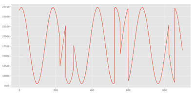

I'm currently using the ADC on the NUCLEO-H743ZI2 board to sample a low frequency sine wave signal.
The ADC is configured to DMA, circular buffer, continuous sampling mode and oversampling ratio of 4 with 2 bits shift.
When I set the ADC sampling rate to 250KHz and the sine wave signal is 100Hz.
Here is the sampled signal I got:

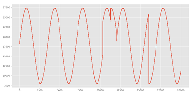

When I reduced the ADC sampling rate to 125KHz, the sampled data is correct:
Does anyone know what's causing this?
Do I have to reduce the sampling rate?

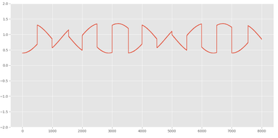

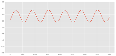

I also did use the HAL_GPIO_WritePin() in half callback and complete callback to check the sampling frequency is correct.
I just found that when I reduce the functions inside the half and complete callback.
The ADC is less likely to produce the glitch. Below is the code and graph.
void HAL_ADC_ConvCpltCallback(ADC_HandleTypeDef* hadc)
CDC_Transmit_FS((uint8_t*)&adc_buf[BUF_LEN_HALF], BUF_LEN_HALF*2);
adc_buf_counter++;
for(int i=0; i<BUF_LEN_HALF; i++)
float val = (float)adc_buf[i+BUF_LEN_HALF];
DSP_buf1[i] = val;
arm_scale_f32(...);
arm_biquad_cascade_df1_f32(...);
arm_mult_f32(...);
arm_mult_f32(...);
arm_add_f32(...);
arm_scale_f32(...);
arm_mean_f32(...);
HAL_GPIO_WritePin(GPIOC, GPIO_PIN_7, GPIO_PIN_RESET);
With less functions:
adc_buf_counter++;
Glitches are less likely to occur, but they are still there.
2023-06-26 12:48 AM
It looks like you are doing a little bit too much in the callbacks, so that the buffers are filled while you are still working with them.
Try to increase DMA buffer size, reduce calculations, maybe even try to use DMA's double buffer mode.
