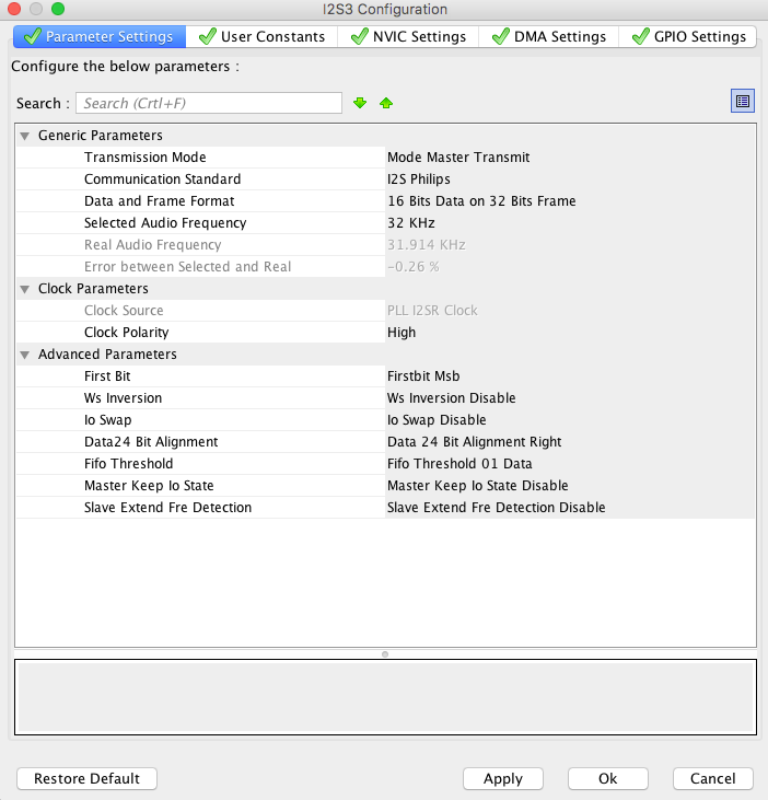

HI, I'm trying to interface this board to a cirrus logic CS42448 codec. I set up the I2S3 peripheral in slave mode configured in CubeMX as so:
The project is built with this and in the main while loop I have a simple bit of code to get it to transmit some random data:

The codec is providing the LR/WS clock and bit clock and I have it running at a sample rate of 32kHz (my logic analyser has limited bandwith). I can verify however that the clocks are coming in at the right frequencies with my logic analyser, however there isn't any data coming out of the board.
When I re-configure the board in I2S master mode however and disconnect the codec, with the exact same settings and code I can see there is data coming out.
Thanks!
