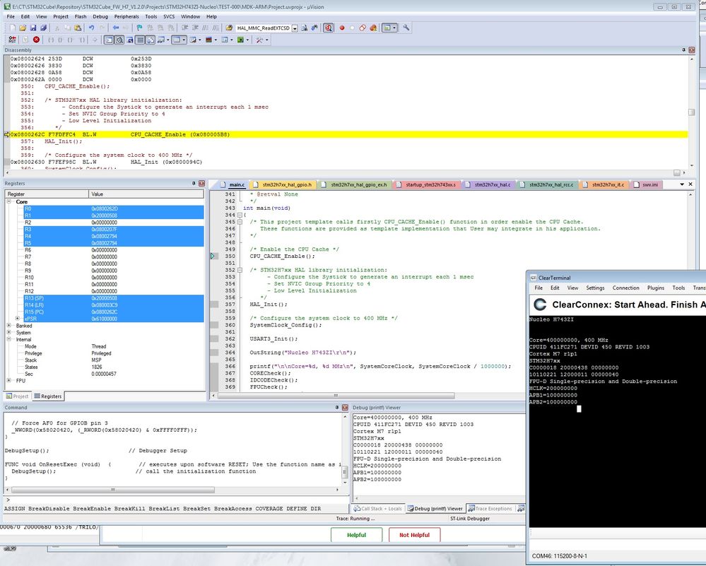

2018-08-09 5:17 AM
Here working in Keil via the debug script. The code from the previous post is more effective across different speeds (ie 100-500 MHz), and means you don't have to know the frequency for it to work in the ST-LINK Utilities SWV Viewer, etc.

2018-08-12 10:01 PM
OK, it now works well. There were two tricks:
Without the second step, the print out appears as garbage characters (but also means something is working). Thanks for your help. Also have Keil installed now.
