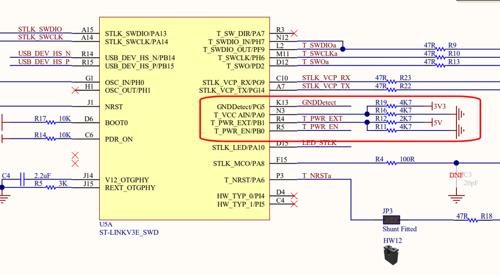

2026-01-20 4:00 AM
@LPetr.1 wrote:my hardware knowledge is somewhat limited
unfortunately, hardware is critical here - it's not just a software issue.
When the microcontroller's consumption is only a few uA, then it only takes a few uA of leakage elsewhere in the circuit to "swamp" that...
@LPetr.1 wrote:regarding the
- Target VDD measurement by the ST-Link.
It is not fully clear what you mean, perhaps you could clarify?
When you connect to, say, CubeProgrammer, you'll see that it reports the Target voltage.
To do this, the ST-Link needs a connection to the MCU supply in order to measure it.
In this case, it looks like you're OK:
The "3V3" there is isolated by removing JP6.
