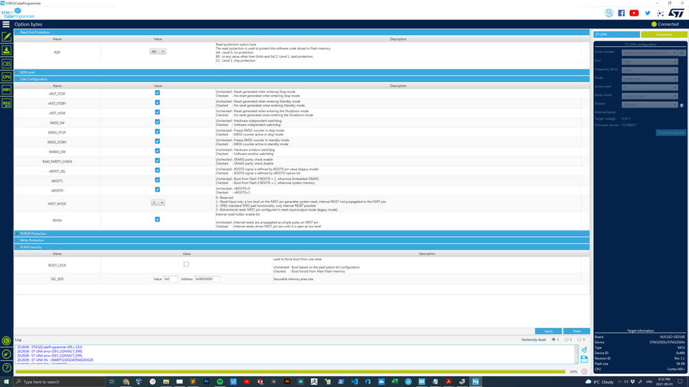

I really appreciate the help. Is it safe to assume these user configuration settings are how I control the NRST behavior? I'm not sure what I'm looking for exactly. Like I said I'm new to the STM32 family so bear with me...

Any debugger will work, the onboard one would be a lot simpler.
Looks like your NRST pin is in GPIO mode, so the level on there shouldn't affect the program.
