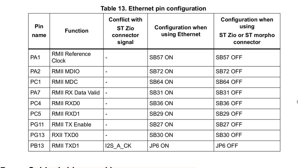

2024-02-22 4:29 PM
Check out UM2407, there are listed some jumpers for ethernet to remove first.
