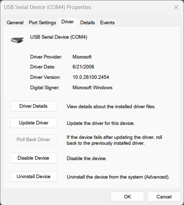

I copied serial_gobbler from your post and adapted it to my data stream. My maxread is 4k while yours is 16k which I think accounts for the ~4x faster speeds that you get. What device driver are you using?
Received 257344 bytes over the last 1 second (2.06 Mbps) (n=64, minread=1696, maxread=4096)
Received 254944 bytes over the last 1 second (2.04 Mbps) (n=64, minread=1696, maxread=4096)
Received 245056 bytes over the last 1 second (1.96 Mbps) (n=61, minread=1696, maxread=4096)
For me, device manager shows this:
-Marc
2025-12-30 7:39 AM
My driver page looks the same as yours. Standard device driver with Windows. I have done no customization other than keeping windows up to date.
