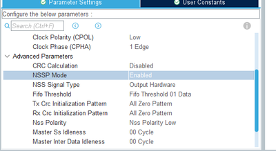

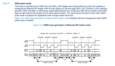

This is a question related to SPI communication.
What is NSSP mode? What does it do?
Also is there any documentation that explains all parameters in detail other than this

@Saket_Om Thanks a lot
