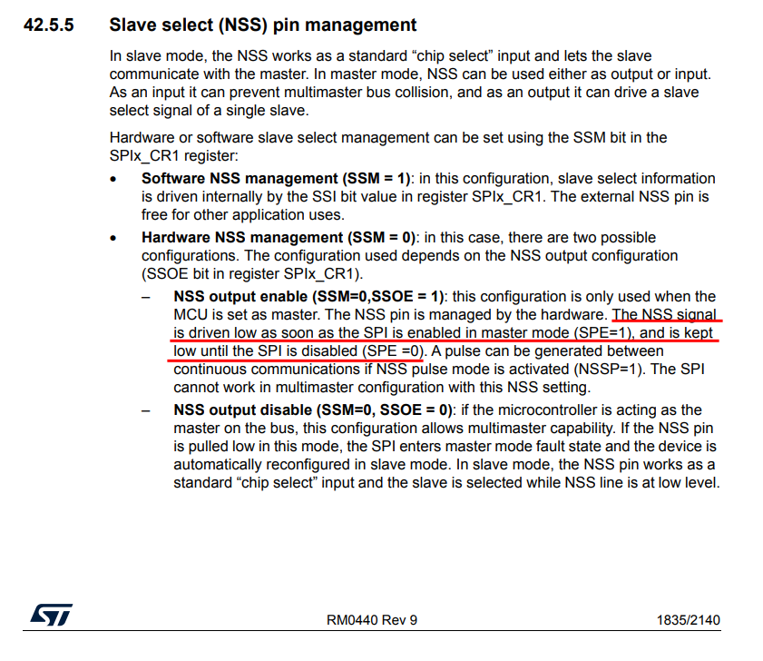

Pin 'd stay low as long as SPI active. Use I2S instead, right/left channel line is your NSS in this case.

@BrindhaP this is documented in the Reference Manual:
via: https://www.st.com/en/microcontrollers-microprocessors/stm32g474re.html#documentation
