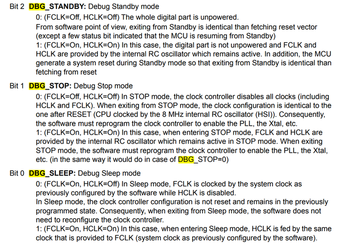

Your issue is very simple. You prog MCU with debug in low power mode set. This config DBG register and this isnt overide with reset. Only power off or in code change register DBG... or in your IDE set no debug in low power...

Really? as far as I know, debug in low power mode can increase current consumption (until you POR), but it doesn't actually mean you take the MCU out of sleep mode. Do I have it wrong?

@BarryWhit wrote:Really? as far as I know, debug in low power mode can increase current consumption (until you POR), but it doesn't actually mean you take the MCU out of sleep mode. Do I have it wrong?
It means that the clocks are not stopped during the Sleep mode - so the expected current reduction will not be seen.
But the MCU should still wait for the usual "wakeup" signal.
2024-06-28 6:56 AM - edited 2024-06-28 6:59 AM
Right, but OP is not about current reduction, or even low power modes (non-native speaker, so admittedly hard to parse). It's about programming the chip and having the new program seemingly not taking effect even after a manual reset. Only after a POR is performed.
Since LP debug mode should not effect the observable runtime behavior (docs say it's there so you can set breakpoint on wakeup ISR while CPU is in low power mode), the answer given by MM..1 still makes no sense to me.
@MM..1 says I'm wrong. I wish he would explain why.
