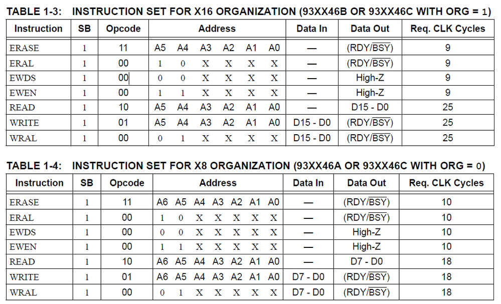

did you see this?
table 1-3 INSTRUCTION SET FOR X16 ORGANIZATION (93XX46B OR 93XX46C WITH ORG = 1)
how many clock cycles are you sending ?

Yes I saw this map and most of the addressing is based on this. I don't know how I can send odd number of clock cycles since all the data is either 8, 16 or 32-bit. Wherever there are 25 or 29 clock cycles need, I seem to be sending 32 and where the required cycles are 9, I seem to be sending 16.

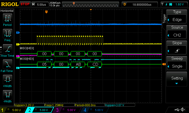

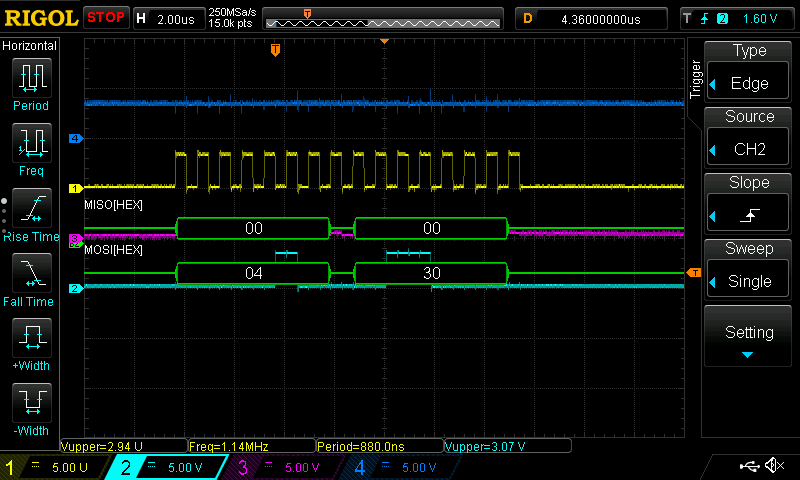

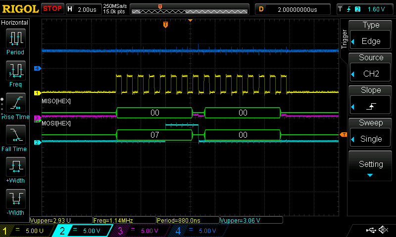

Here are the scope waveforms for ENABLE, ERASE and WRITE.
For ENABLE (Start bit is 1 and opcode for ENABLE is 00. Combining them comes to 0x04)
For ERASE (the 0x00 is the EEPROM address that I want to erase. Start bit is 1 and opcode for ERASE is 11. Combining them comes to 0x07).
For WRITE (address is 0x00, data is 0xABCD. Start bit is 1 and opcode for WRITE is 01. Combining them comes to 0x05).
