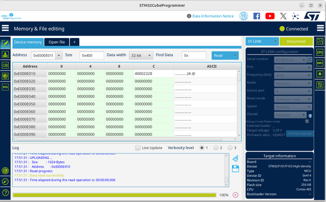

Below is the screenshot of the cube programmer window after I flashed the code -
As you can see, the SYSTICK registers do not have the value I tried to write. My code only contains this piece of code which I shared. Is my code missing something that needs to be added or some other register that needs to be configured?

I flashed the code but it didn't work. Then I debugged the code and saw that the system ticks are not incrementing. I flashed the code and then checked the register contents on cube programmer. The SYSTICK register was not set as you can see in the screenshot.

I'm not sure of the efficacy of using STM32 Cube Programmer in this manner.
Can't you use the debugger, and do a "peripheral view", or for that matter using a serial port to dump the register content of interest to the terminal?

I'm just saying to inspect the relevant plumbing to understand why the interrupt is not occurring.
You need to follow the code flow, not sure if the code is running at the point you're inspecting the Cortex registers, would perhaps read a couple of the registers rather than a block of 0x400 bytes.
Generally better to do in the debugger, and whilst stepping through the code.
Perhaps check also with working HAL code, to see what the register look like in working cases.
