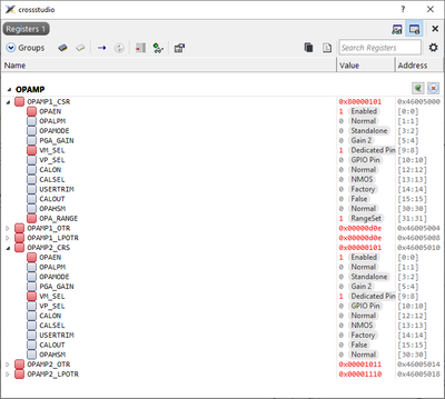

  • share the revision of the used devices
  • read the value of the bit field VM_SEL in both OPAMP1_CSR and OPAMP2_CSR

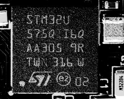

Silicon revison is W, see attached picture, all devices the same. See also the snapshot of OPAMP registers from debugger.

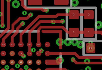

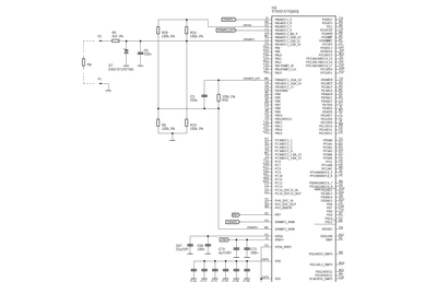

Thanks for investigation, the problem persists. See the attached snippets of code, principal schematic, a cut from real board routing and X-rayed board, confirming there is not bad connection under the M2 ball.

When saturated, the pads 1 (C3, R32) have Vdd/2, pads 2 have VDDA.
