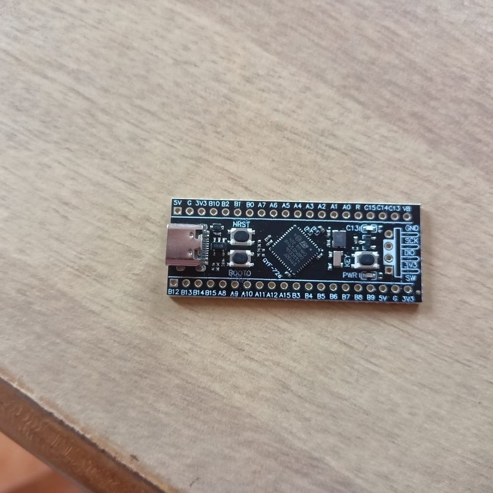

I have connected STM32F411CEU6 using USB C type cable. Can you please tell me what " debug Pod " is?

I know and use this quite good board (but not the same version).
The question is what probe do you connect to the SW 4 pin connector (GND, SCK, DIO, 3.3V) ?

So you DON'T have an ST-LINK, which is why its NOT FINDING ONE..
https://www.st.com/en/development-tools/st-link-v2.html https://www.st.com/en/development-tools/stlink-v3set.html
These would connect via the SWDIO, SWCLK, GND, etc
For the Black Pill you can use USB/DFU mode, would need to use STM32 Cube Programmer, and connect with BOOT0 button pressed. Device would then be found as "STM32 BOOT LOADER" type device, and you can access via STM32 Cube Programmer in USB mode.
This WON'T allow for debugging, just programming.
