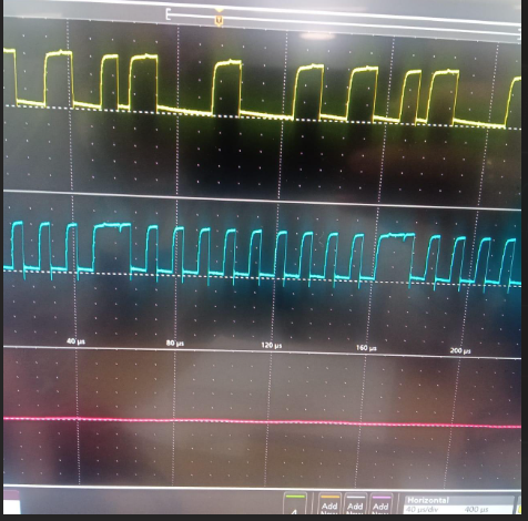

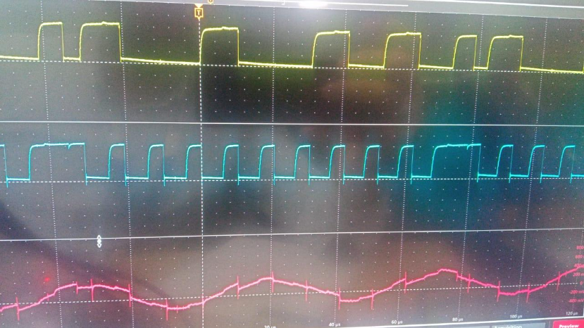

Could you please share a screenshot from the analyzer?
Foued
SDA-YELLOW ,SCL-GREEN,PIN P0 =RED

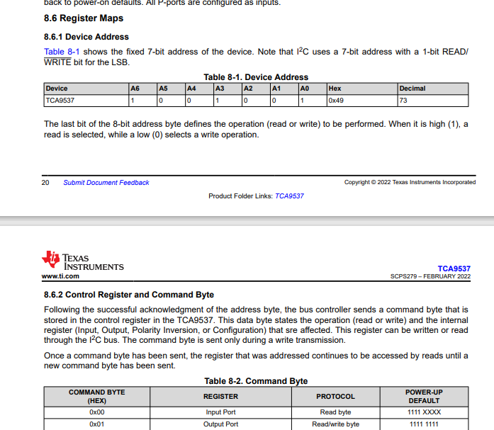

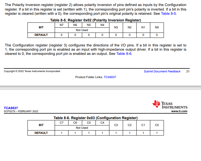

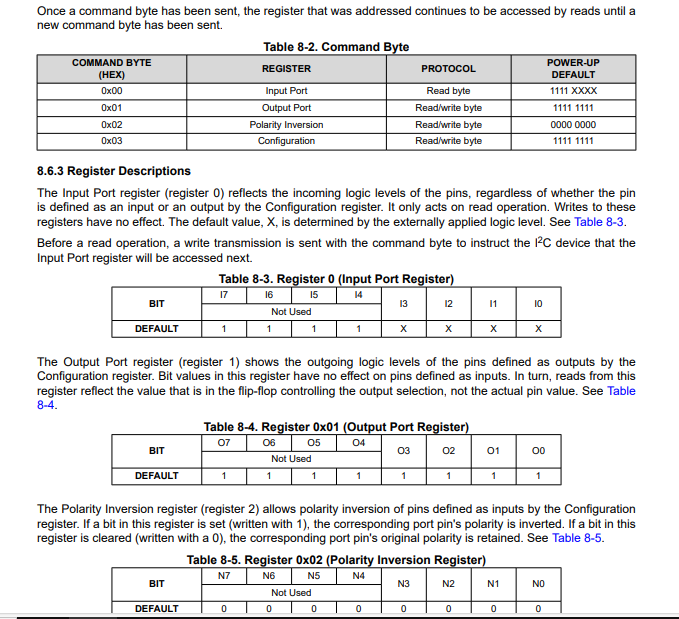

Verify the TCA register addresses your using relative to Table 8-2.
