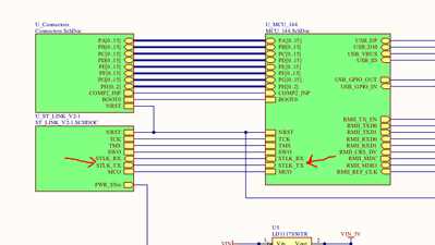

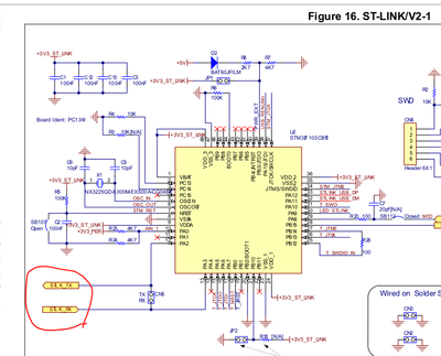

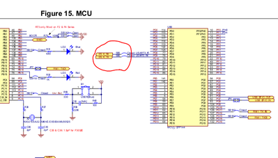

> i didn't understand it since my St-link v3mini is connected to my stwinbx1 board via this cable directly (image below) and then from St-link V3mini to my pc via USB-b, that's it.
This cable provides the debug connection.
You would need to check the documentation of the adapter and the schematics of your board to see if this connection provides the serial connection required.
Here the respective parts of the schematics from another STM32 baord, with onboard ST-Link.
And in the detailed schematics:
ST-Link ...
... and the MCU.
The board this example is from is the F746 Nucleo I had at hand.
As you can see, the serial connection between onboard ST-Link and target MCU exists on board level.
With your board, this is obviously not the case.
