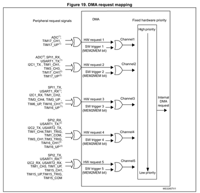

According the the drawing on page 151 in the reference manual for STM32F030F4P6 it looks like there are trigger inputs from the basic timers TIM14, TIM16 & TIM17 to trigger the DMA transfer
I don't see TIM14 on there. I see the other two.
> When I'm looking on the setting options for these basic timers TIM14, TIM16 & TIM17, I do not have any option for an trigger event (TRG0) from these timers. I'm only able to pick Input Capture, Output Compare & PWN generation from the available options in CubeMX
I have no issues setting DMA in CubeMX on TIM16. With TIM14, it's not there because it's not an option.
TRGO options don't seem relevant here. These timers don't have one per the RM. Use the update event to trigger the transfer. Or the CH1 event.
I suspect you're mistaking TIM14 for TIM15 in the manual. They're very different.

The idea is, that in timer you enable individual DMA triggers in the same way as you enable individual interrupt triggers - even in the same register, the mentioned TIMx_DIER. As @TDK said above, for you, the relevant options are Update or CC1 i.e. TIMx_CH1 output compare event. Then you set up the respective DMA channels - as the figure @TDK has shown above indicates, individual triggers are ORed at the input of DMA (in case of collision with other DMA trigger sources from other peripherals, the 'F030x4 offers remap, see footnotes to that figure and/or SYSCFG_CFGR1.TIM16_DMA_RMP/TIM17_DMA_RMP.
