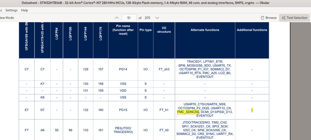

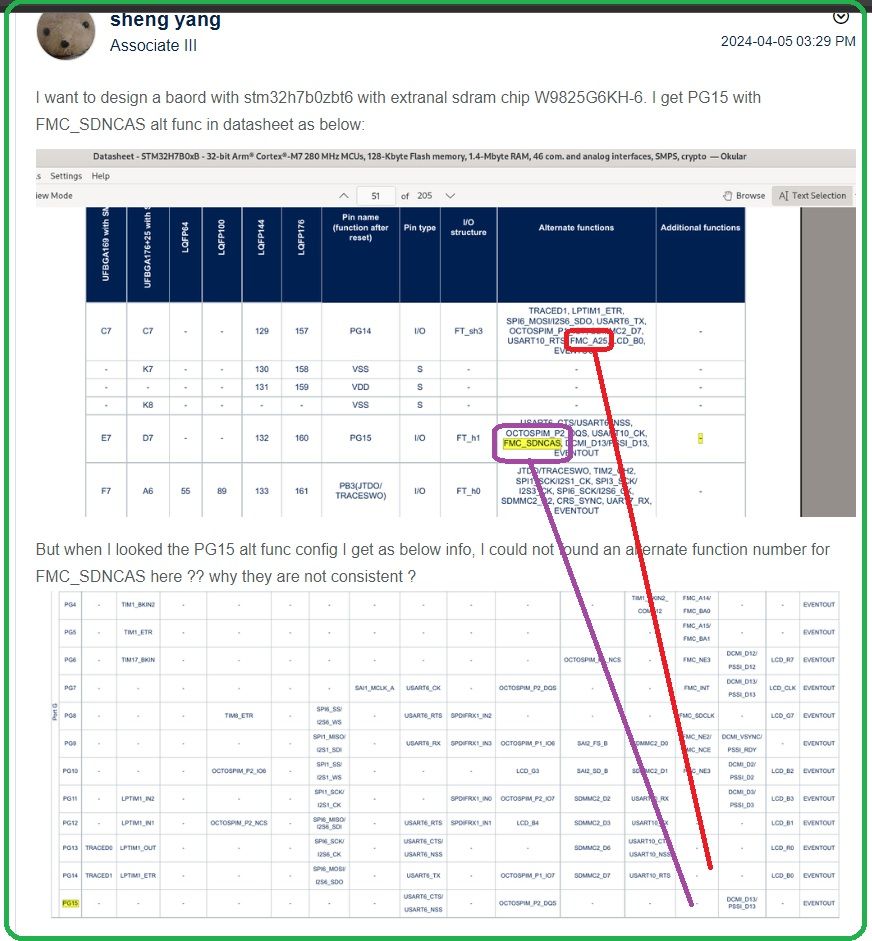

I want to design a baord with stm32h7b0zbt6 with extranal sdram chip W9825G6KH-6. I get PG15 with FMC_SDNCAS alt func in datasheet as below:

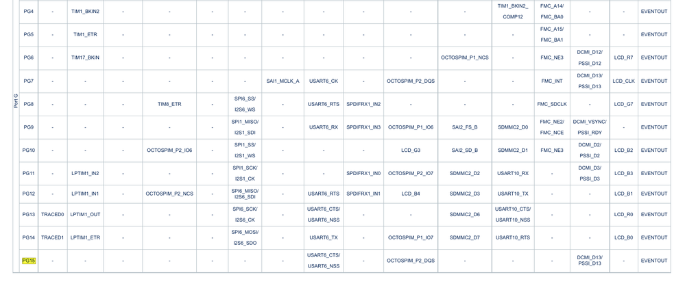

But when I looked the PG15 alt func config I get as below info, I could not found an alternate function number for FMC_SDNCAS here ?? why they are not consistent ?

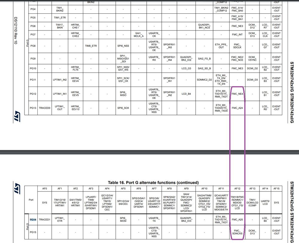

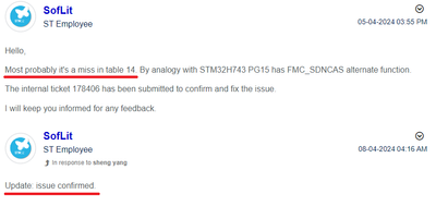

Most probably it's a miss in table 14. By analogy with STM32H743 PG15 has FMC_SDNCAS alternate function.
The internal ticket 178406 has been submitted to confirm and fix the issue.
I will keep you informed for any feedback.

2024-04-08 4:16 AM
Update: issue confirmed.
The internal ticket 178406 has been summitted to fix this issue.
Thank you.

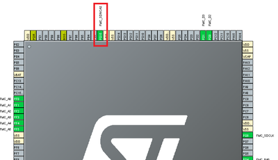

Moreover, CubeMx has already the correct alternate function FMC_SDNCAS on PG15:
The the only stuff to fix is the table 14 in the datasheet: PG15 should have FMC_SDNCAS alternate function on it.
