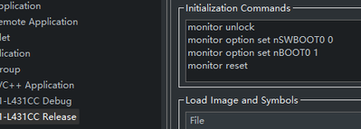

BTW, what a pity that "Project property::Release Configuration::Startup::Initialization command" does not work.
can not find more doc on this topic.
