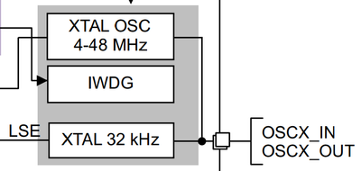

@nitin29 wrote:Now at page 27th, the datasheet talks about pinout and points to PC14-OSCX_IN and PC15-OSCX_OUT. !
Those can serve as IN and OUT for either the High-speed internal oscillator (4-48MHz) or the Low-speed internal oscillator (32kHz) - hence the 'X':
Elsewhere in the document, they are referred to as OSC32_IN/OUT when used for the 32kHz oscillator, and OSC_IN/OUT when used for the 4-48MHz oscillator:

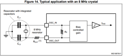

But, in general, for reliable UART communication you certainly should be using a crystal. Choose one which allows you to generate standard baud rates (9600, 115200, etc) within acceptable errors.

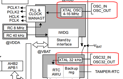

Note that the STM32F1 had separate pins for OSC_IN, OSC_OUT (4-16MHz) and OSC32_IN, OSC32_OUT (32kHz) :
The sharing of the OSCx_IN/OUT pins is quite a new feature.
