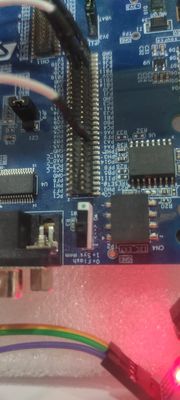

Hello @mƎALLEm ,
I mean the switch provided for STM32H757I-EVAL, as in this image.
Suppose if I want to load the firmware in Flash so that every time the device is power on, the older loaded program should retain and shall run.
Now every time I make the device on the program doesn't run, I have to load it again and again.
If there are some settings or configuration to do, then please let me know.
Please feel free to ask if you need something additional.
