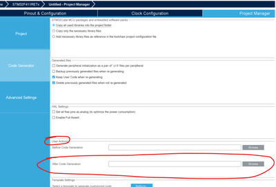

Thanks, this is actually what I wanted. Putting a shell script into main folder and running after code generation patches files I needed.
