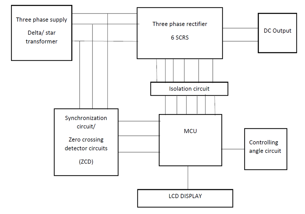

Dear Sir Avatar,
For seek of simplicity, let me add a control diagram which in case should be modify in detail. This is older one.
Here we go
In my experience, the actual data flow to/from the device is not the problem. But hardly any ''IoT'' device works properly in a normal office network, the by-going traffic just floods the network interface. If you can control such unrelated traffic (e.g. with an ethernet switch), this should work as well.
If the network has complex algorithm, which tool you could suggest?
The electrical measurements sound pretty standard, the transducers/converters to get MCU-allowable voltage levels are much more expensive than the MCU itself.
Selecting a suitable MCU is important. Which one you want to suggest?
2018-06-11 4:28 AM
In most cases, the protocol on the MCU and the remote site ist not the problem.
Rather, it is unrelated traffic generated by other ethernet nodes. MCUs tend to have simple PHYs without deep package buffers, so the MCU needs to check each received frame. For a decent 100MBit network, this usually floods the core, eating up >100% performance at peak load situations.
I don't know the network environment of you nodes. If you can keep all disturbances out, and reduce traffic to those related to your application, a STM32F4xx might work.
For the 'IoT' stuff so heavily advertized everywhere, this is almost never the case.
Ethernet and graphics tend to suggest a Cortex M4 like the F4 series, or a M7.
This MCUs use to have at least 2 ADCs (>= 16 channels) with internal calibration, I would perhaps reserve one channel for an external reference voltage.
I would invide a ST representative, and ask him.
He can suggest you proper evaluation boards, and will keep your information confidential.
Just make sure you get a technical expert, not a sales-only guy ...
