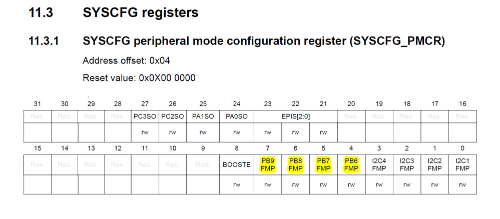

It depends on GPIO properties. In fact, not all pins provide a fast mode option. As mentioned below, extract from Reference manual, you can configure only PB6, PB7, PB8 and PB9 pins in fast mode. Therefore, This is why you can only configure I2C1 pins (PB8 and PB9 ) and I2C4 pins (PB6 and PB7) in fast mode, and not I2C2 pins (PF0 and PF1) or I2C3 pins (PA8, PC9).
Hoping it helps you, please do not hesitate to contact me for further details.
