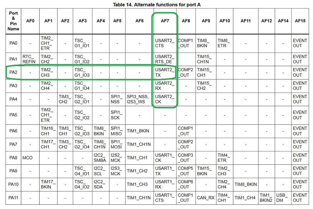

Also needs mapping through the mux
/* Connect PA2 to USART2_Tx */
GPIO_PinAFConfig(GPIOA, GPIO_PinSource2, GPIO_AF_7); // USART2 MUX AF72018-02-16 3:27 PM
It now works.
I have often wondered how the 'AF' devices connect to the pins. Can you point to a document that clearly explains this? The RM0316 on the STM32F303 MCU does not cover it much.
Thanks Clive,
Randy
2018-02-16 3:34 PM
Data Sheet, Table 14
