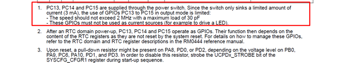

I reviewed the datasheet and discovered in (Table 11. Pin assignment and description) that using PC13/14/15 has output limitations in certain cases. However, in my design, PC13 is configured as open-drain output with external pull-up resistor.
Could this be the cause of the malfunction?
2024-09-24 6:17 AM
@Wadeva wrote:PC13/14/15 has output limitations in certain cases. However, in my design, PC13 is configured as open-drain output with external pull-up resistor.
Unlikely.
The limitation there is just about sourcing current, not sinking - see:
Open-drain can only ever sink current.
