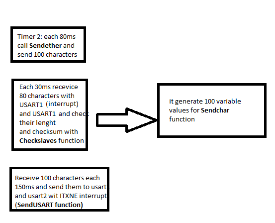

would it be possible that ground wire between Ethernet and my board cause a problem during process?something like this:
and Dear max thanks for you tip that I never pay attention to them before. is it possible how can I define for my MCU(stm32f10x)?
Thanks in advance

2017-04-02 11:20 PM
Thanks for your replay and your contribution
Here is
user name:
mailto:parisa.mohamadi227@gmail.com
password:stm32forum
I have set USART and Timer different interrupt priorities. But I didn't set anything for ETH , doesn't SPL Ethernet library set it correctly at high priority?
