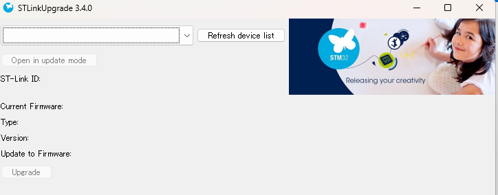

Then I tried to upgrade ST-link.
But there's not any device to upgrade.

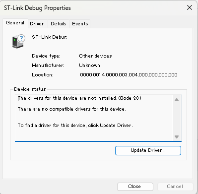

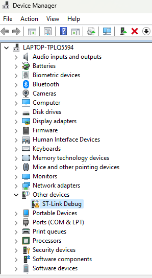

So I also saw Device Manager.
And I found a something to caution.
Then Cricked and tried to search the drivers of ST-link Debug.

Uninstall drivers, rebooting, installing drivers, rebooting, then connecting the boards may fix it.

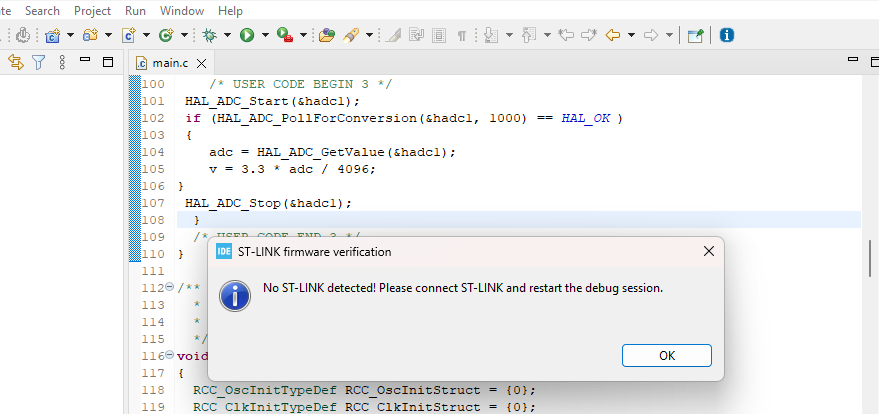

Cricked this icon to debug.
But this caution popped up.

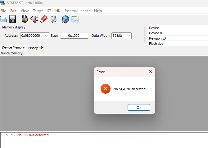

You mean ST-link utillity?
I cricked this.
But this caution appeared.
2023-11-12 11:45 PM
The ST-Link utility has not been recommended for use for a long time, which is why you should remove it from your tool pool and your memory.
But your STLinkUpgrade would also benefit from an upgrade from the hopelessly outdated version 3.4.0 - presumably you are still using an old version of STM32CubeIDE?
