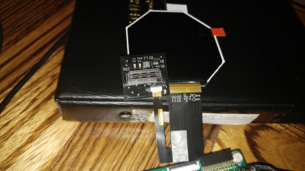

I am doing well. The Panasys 3.4' round TFT (actually it's about 2.4' round, in an octagon, that was probably cut from a 3.4' square once upon a time) MIPI DSI display is working on the stm32l4r9i-discovery, after I made a little adapter board with backlight driver. (
https://www.eevblog.com/forum/projects/critique-my-first-pcb/msg1672430/#msg1672430
)but.. the circle is offset, and I'm sure it's because the GFXMMU LUT is for the 390*390 amoled.
I looked at CubeMX, and also I read the AN5051 application note. This says that the panel manufacturer will say what is the first and last pixel of each row.
But they don't:(
Can't this be worked out? Something to do with Pi and what not?
Do I really have to enter each start and end pixel for my 320*320 round TFT?

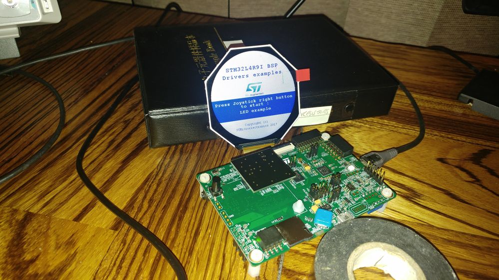

It works :)
It's been quite a successful weekend. I roughly understand how to use TrueStudio and CubeMX, and how to compile the example code.
My first attempt at a PCB design has worked out (Discovery DSI adapter board for Panasys LCD, with back-light driver), as well as my first attempt at reflow soldering with a toaster reflow oven.
And then, getting the actual MIPI DSI screen working with the example code has worked out successfully too!
I do have a question though, if anybody knows about round TFTs. In the example code, they give pixel xPos (column) = 0 for centered text. This didn't work for my panel. I had to give BSP_LCD_GetXSize() / 2 (i.e. 160.. the middle).
Do some round displays treat 0 as the centre? Or have I missed something else somewhere? I have basically looked for everything to do with 390*390 and changed it to 320*320..

Yes that's right for this screen. But in the original st example code, which is for the G1120TB103GF-001 amoled screen, the centre-text function seemed to give an xPos of 0. The function seems to put the centre of the string at this location, so that it's centres the whole string on screen. With that xPos of 0, everything was actually at 0 as you would expect.. and not centered on the screen at all. So I changed the funtion to say if xPos == 0 { xPos = screenwidh/2) and now it's correct and all good!
Just wondering how it was ok on the original amoled screen with xPos = 0
