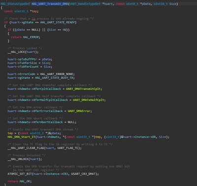

I've checked what HAL_UART_Transmit_DMA() does :
And there was this HAL_DMA_Start_IT(). So it works that DMA sends it's data from memory to UART TX registers. Ok. So tmp is the memory we have the data, and the Instance-> DR is the register the data must be sent.
So where exactly there is info about turning on the UART to transmit data, and when does the DMA know that UART sent 8 bit and is ready to send another 8 bits ?
I've also noticed this :
But I don't understand what it does ? It turn on the UART transmit ?

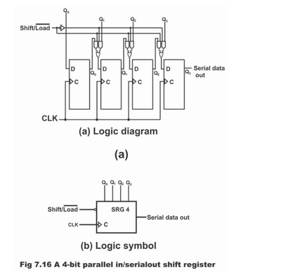

> The UART Tx hardware is basically a shift register and a counter (which counts, how many bits remain to be transmitted, i.e. at the beginning it's at 0). TXE is a flip-flop, which after enabling transmitter is set to 1. When you write a byte into the data register, TXE gets cleared. Then UART checks, if the counter is zero, and if it is, the byte gets transferred from the data register into the shift register, together with a startbit and a stopbit, and at the same time the counter is set to 2+8 (or whatever the data length is). Data register is now empty so TXE gets set to 1. If you now write another byte in to the data register, TXE gets cleared and it does not get set to 1 again until the byte is transmitted from the shift register and counter is zero. The baudrate generator clocks out the bits from the shift register and at the same time decrements the counter; as soon as counter gets to zero, baudrate generator thus transmission stops. If there is already a byte in the data register, it gets transferred to the shift register, TXE gets set, and the whole process starts again.
Something like this ?
But this picture is not enough. Because there must be something a logic gate to stop UART from transmiting and stops the clock ? To make sure the data is set in the shift register. Or rather I don't know if I am right but the clock must be disabled in shift register to not send data I think ?
The TX flag is from different register I guess ? And it acts as input or as output, I wonder how.

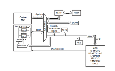

The picture how DMA works doesn't tell a lot :
Like how it works exactly AHB Slave I believe is for configuration like which channel or which devices uses this DMA, and the DMA output bus I guess is to make this transfer, I wonder how it works like it know the address so it goes to that address and takes somehow the value and stores it in a register not shown in the RM ? I guess. How he searches the devices/memory like there is some logic gates for scanning already built in ?
