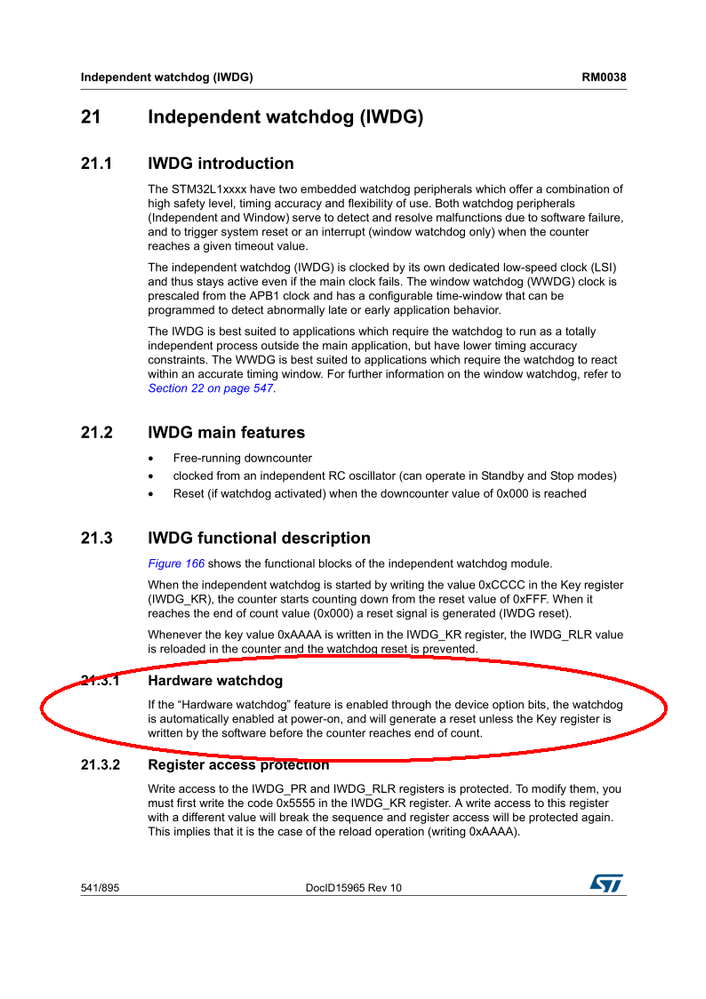

2021-08-04 4:53 AM
Have you checked the Option Bytes (namely the IWDG_SW bit in them) on those 2 boards?

I don't know what is RCC_FLAG_IWDGRST.
I am asking about the Option Bytes, i.e. nonvolatile bytes which may be programmed during device programming.
