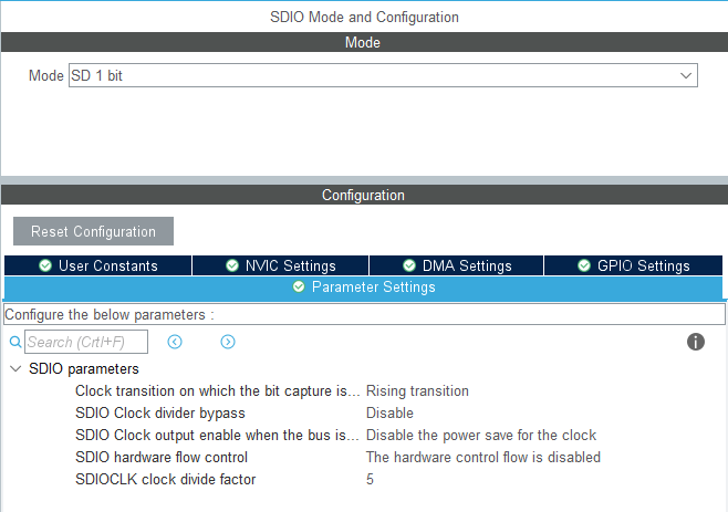

I'm trying to configure SDIO in several modes:
Only 1 bit is working for now. When I enable DMA in 1 bit it double writes things into my files. 4 bit mode on the other hand mostly gives me error " FR_DISK_ERR" after closing file (after creating it) or just doesn't do anything.
I tried A LOT of CubeMX configurations, and editing bsp_driver_sd.c and sd_disko.c files, but nothing seems to help.
I'm using:
I won't be showing you my code for using fatfs because I'm sure that it works, and I have it in several functions - so thats just unnecessary (but if you would like to see it, i can post it, no problem).

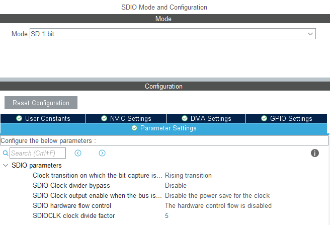

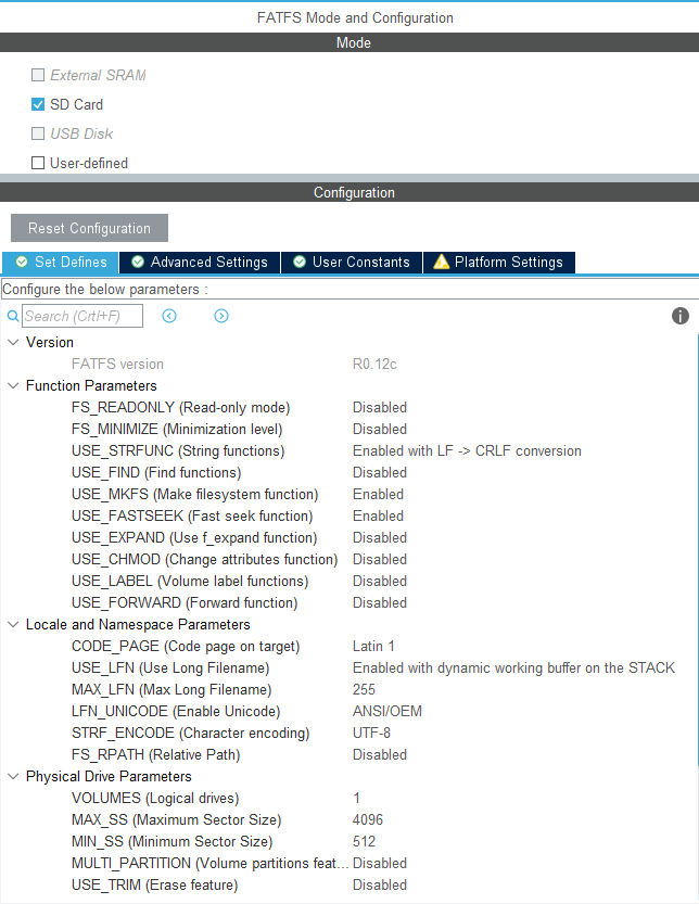

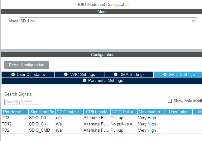

Okay, so first my config for WORKING 1 bit mode:

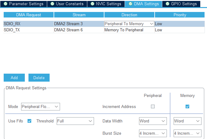

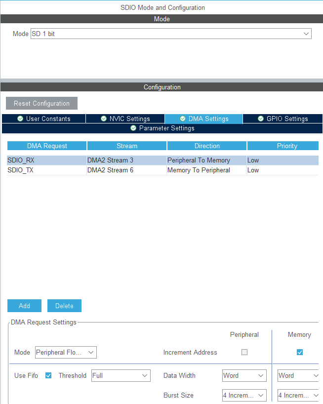

Now, 1 bit + DMA mode, that's not working well. It reads fine, creates files, but ALWAYS double writes things to files!

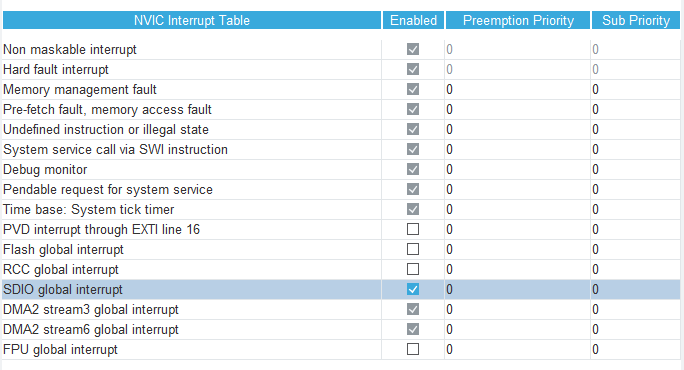

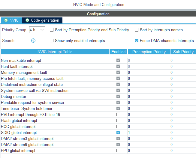

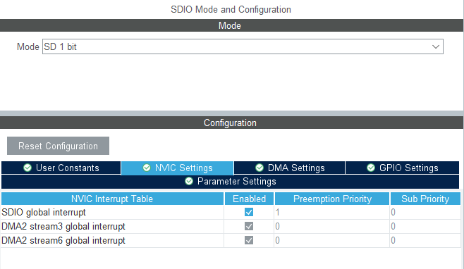

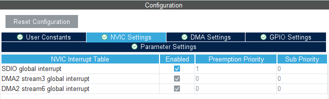

Now a little comment on the priority: I tried setting SDIO global interrupt preemption priority to 1 so it would be lower than dma's interrupt, but it didn't work.

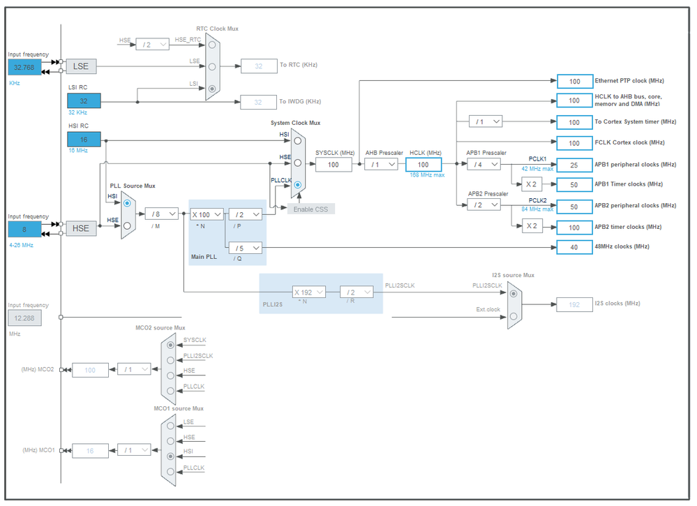

Clock configuration the same as in the previous example.
Also, I tried decreasing clock speed on SDIO, by setting APB2 to 24MHz, or by increasing the CLK divide factor - it didn't help.
Code:

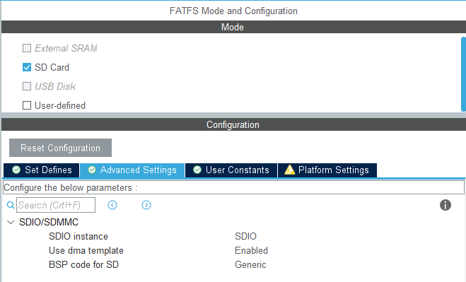

My another wonder is, why cubemx doesn't generate me lines in user code 2 section, in 4 bit mode:
static void MX_SDIO_SD_Init(void)
/* USER CODE BEGIN SDIO_Init 0 */
/* USER CODE END SDIO_Init 0 */
/* USER CODE BEGIN SDIO_Init 1 */
/* USER CODE END SDIO_Init 1 */
hsd.Instance = SDIO;
hsd.Init.ClockEdge = SDIO_CLOCK_EDGE_RISING;
hsd.Init.ClockBypass = SDIO_CLOCK_BYPASS_ENABLE;
hsd.Init.ClockPowerSave = SDIO_CLOCK_POWER_SAVE_DISABLE;
hsd.Init.BusWide = SDIO_BUS_WIDE_1B;
hsd.Init.HardwareFlowControl = SDIO_HARDWARE_FLOW_CONTROL_DISABLE;
hsd.Init.ClockDiv = 7;
/* USER CODE BEGIN SDIO_Init 2 */
if (HAL_SD_Init(&hsd) != HAL_OK)
Error_Handler();
if (HAL_SD_ConfigWideBusOperation(&hsd, SDIO_BUS_WIDE_4B) != HAL_OK)
Error_Handler();
/* USER CODE END SDIO_Init 2 */
}I found it on this post: https://community.st.com/s/question/0D53W00000sq1zbSAA/usb-msc-sdio-dma-combination-make-me-crazy-cant-solve-problem-help-needed-indeed
Are they necessery?

UPDATE:

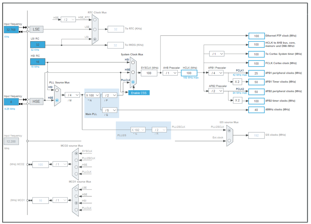

I got 1bit+dma to work. Here is my config in CubeMX for anyone struggling too:

UPDATE:
2021-08-06 2:36 AM
Also, my 4bit+dma started working. Turned out that printf blocked it. :)
