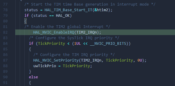

"stuck" means that the code seems to have stopped running. I'm coding and debugging in VScode and the following line is highlighted when the pause button is pressed during debugging.
0693W00000QL4QxQAL.pngIn this case, Timebase Source is set to timer 2.
Set a breakpoint there, restart and step into the function. Finally, only NVIC ISER should be set. You can also use Disassembly > Switch to Assembly to see where exactly it stops.

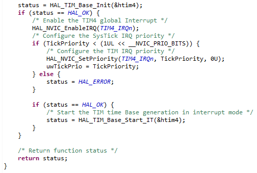

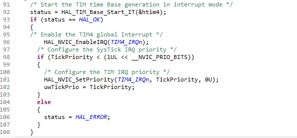

The problem for me was in stm32f10xx_hal_tim_base.c in HAL_InitTick function:
The CubeMX generated code starts the Timer at line 92, and then calls HAL_NVIC_SetPriority at line 101.
A solution would be to flip the order of the 2 function calls to have something like this:
Hope this helps!
