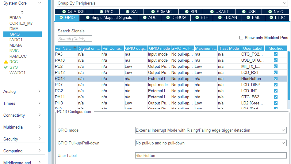

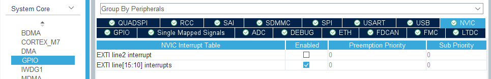

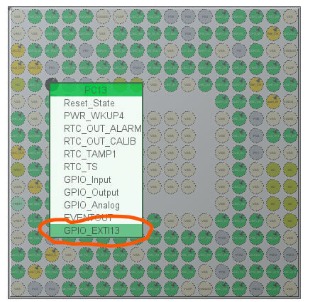

@CG3 It looks like you just want to blink the LED while the push button is pressed but doing it in a while loop is blocking, so you can't do any other tasks.
So instead use EXTI on PC13
Then enable interrupts in NVIC
Then set the GPIO mode for interrupt mode on both Rising and falling edge
Then follow this YouTube video below on how to debounce a push button and also blink an LED all without using blocking code. So even if you are pressing and holding the button, the LED can be blinking while you can do other tasks like parse UART messages, communicate with I2C devices, etc.
There are a handful of examples that I show even counting button presses. You can create unique tasks and a lot more if you have a vivid imagination.
