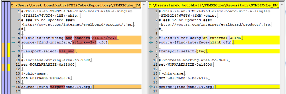

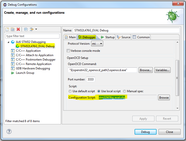

Since openocd supports natively jlink so this is possible using System WorkbenchThis is kind of tricky but possible :)For guidance I will use STM32L476G-EVAL: 1- since you cannot select JLINK from SW inteface, you need to use a cutomized script I will base on default board configuration file ''stm32l476g_eval.cfg'' located in ''C:\Ac6\SystemWorkbench\plugins\fr.ac6.mcu.debug_latest\resources\openocd\scripts\st_board'' copy this file to your workpspace and modify it as followingadapter_khz xxx
>>adapter_khz 240
then from System Workbench > Debug Configurations, select the modified ''stm32l476g_eval.cfg'' as local script''Error: Cannot find jlink Interface! Please check connection and permissions''

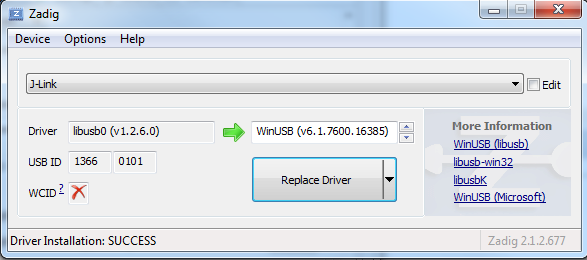

you need to change the usb driver used with jlink (useWinUSB
) to do this use and replace the driver2015-12-04 9:22 AM

My bad... Zadig, sorry.
2015-12-08 2:17 AM
You need to list all devices from Zadig (Menu) > Options > List All Devices
You JLink should be listed in the frontal combo-box.2015-12-08 5:24 AM
Ok, thank you. This worked, but the problem is not related to this as it still occurs.
