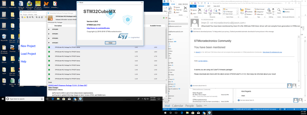

I have added the *.ioc file that produces the code
________________ Attachments : OBDII2.ioc.zip : https://st--c.eu10.content.force.com/sfc/dist/version/download/?oid=00Db0000000YtG6&ids=0680X000006HxqH&d=%2Fa%2F0X0000000b2D%2FAzUlq4wQAAYxyuPgjLgfUCDgPvflrlMnVnm7mYecyWY&asPdf=false2018-03-09 1:05 AM
I have just checked on Cube and its up to date
the MxCube version is 4.24.0
using Manage Embedded Software packages 1.9 has been downloaded etc
TM32CubeF3 Firmware Package V1.9.0 / 23-June-2017
Main ChangesMaintenance release.2018-03-09 1:06 AM
2018-03-09 1:53 AM
Hello
Curran.Danny

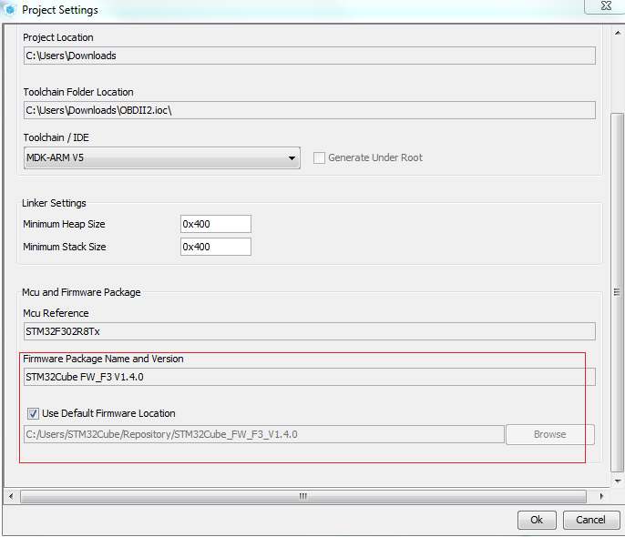

2018-03-09 2:31 AM
When I open your ioc file and Project settings, I see you are using the firmware version
STM32Cube_FW_F3_V1.4.0.
Please check In your Project Settings menu that the firmware package version used is STM32Cube_FW_F3_V1.9.0, Otherwise, you should update the firmware location to use the latest version.

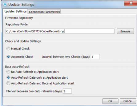

,It's recommended to use latest version of Cube firmware package and CubeMx tool as there is always enhancement and bugsfixes in the new release.
STM32CubeMX can check if there is a
new library package installation or updates
for new STM32CubeMX tool version.For that, in the Help > Updater Settings tab, you shouldenable the Automatic check for updates.
In the Project Tab, there isa Use Default Firmware Location
checkbox
(which is specified under the Menu Help > Updater settings)specifying
thepath forthe
installed firmware packages version and by default, the latest available version is used for the project.I recommend you check the user Manual
''STM32CubeMx for STM32 configuration and initialization C code generation'' for more details.Kind Regards,
