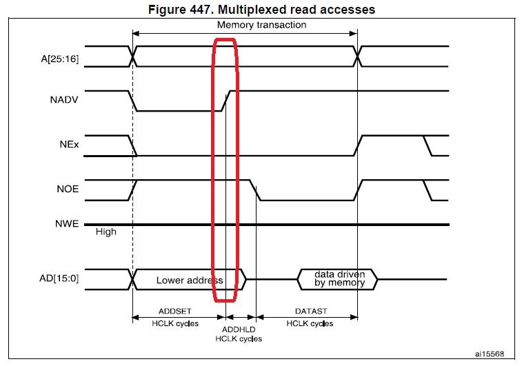

How can I demux adresses from data? I understand the principle of latch but I am not sure how to connect the latch between the MCU and memory. Could you please explain or point me at some article or documentation about the muxed PSRAM communication protocol and its demuxing? In the STM32H745 docs I have found some graphs of write and read operation waveforms but I can't deduce the latch connections from that.
I suppose the AD0-15 pins should be connected to the memory data pins and to the latch input, Latch output and the A16-24 pins should be connected to the addres pins on the memory. Is this correct?
2019-08-17 6:08 PM
You'd take NADV, you'd use it to clock some latches (flop-flops), the rising edge clocks/latches the lower 16 bits of the address bus, and you'd likely want to latch/decode A16..A25 also depending on the transaction mode.
And yes, you'd feed the address to your memory sub-system
