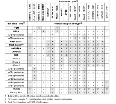

BDMA can only access SRAM4 area, so you have to put your rawValues in this memory !
I would just use DMA1 or 2 , can access all ram areas.
see rm :
You might need to init dma :
HAL_DMA_Init(&hdma_adc3);
HAL_ADC_Start_DMA(&hadc3, (uint32_t *)rawValues, 4);

Great! Thankyou so much that did the trick
