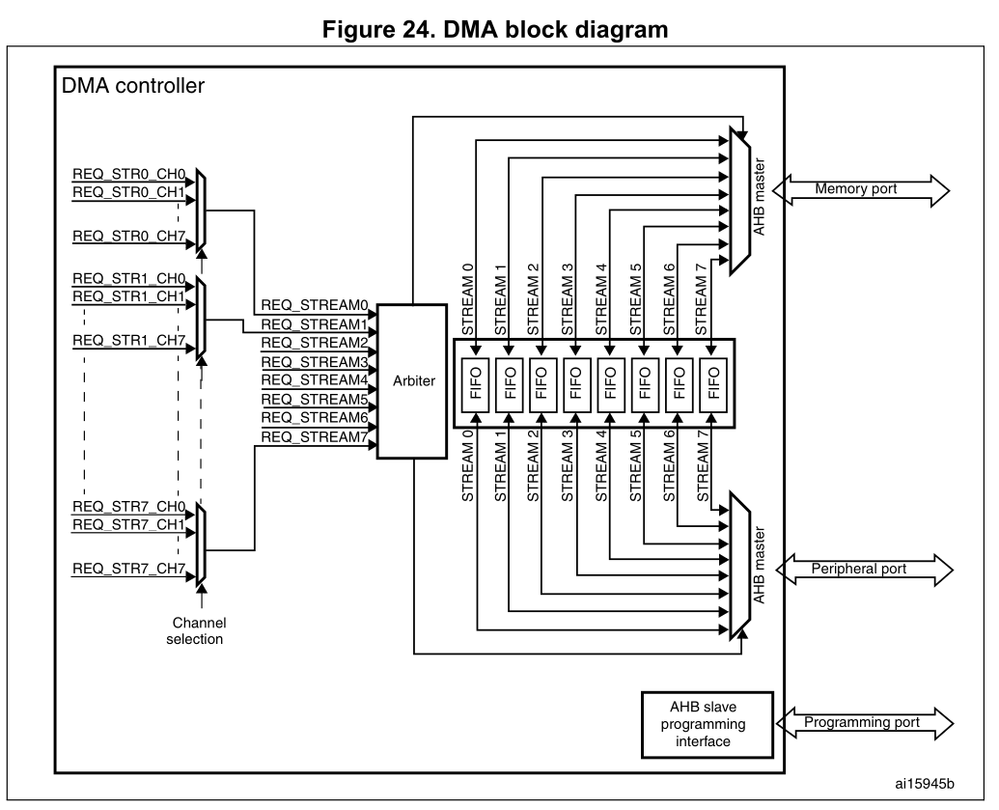

If I understand posred diagram correctly, F4 is not capable to make peripheral-peripheral transaction, there is no switch to routing. Simple solution is to create a buffer in memory, than configure one dma stream adc-mem and another mem-dac, both poited to the same mem buffer.
2023-12-28 7:55 AM
Due two different direction (peripheral to memory and memory to peripheral), Do ı point the memory of buffer
DMA2_Streamx->M0AR &buffer for DMA1 and DMA2 or one of them must be DMA2_Streamx->PAR &buffer ?
Also, do ı need to point data alignment register for DMA1 and DMA2 for example DMA2_Streamx->PAR &DAC->DHR12R1
