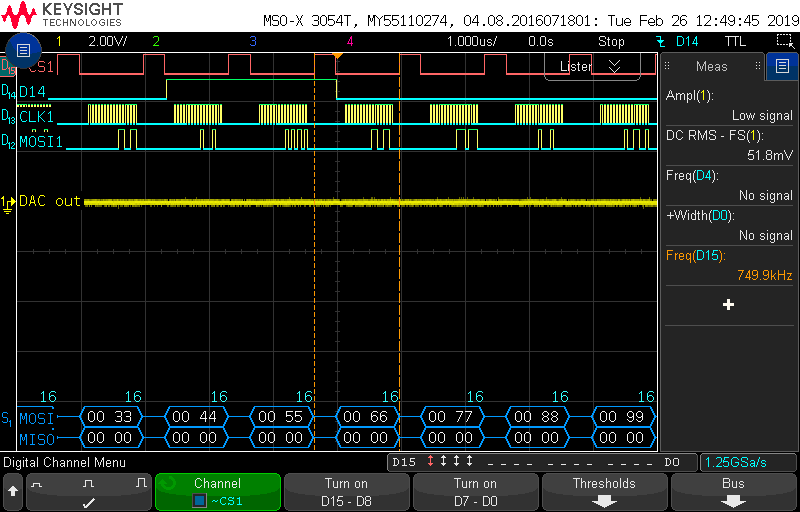

2019-02-26 11:47 AM
This turns out to be much easier than I thought (I missed 'DMA circular mode' first go around).
One timer to:
DMA:
Scope picture below (top trace is CS, bottom 2 traces are SPI clock and MOSI):
