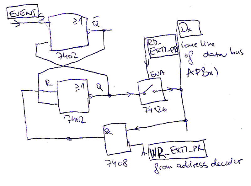

Hardware sets the EXTI_PR bits so that you can read 1 out from them.
By software, the bits you write 1 into them get cleared, so you can read 0 out of them.
Think of 20 R-S flip-flops; with the S line of each flip-flop tied to the internal hardware detecting the edge; the R line tied to outputs 0..19 of a multibit gate which opens from the common bus when the address decoder detects write to the register's address; and the outputs of latches connected to inputs of the gate opening to the common bus when the address decoder detects read from the register's address.

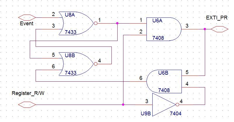

2018-04-18 1:41 AM
Just to confirm, but like this ?
2018-04-18 2:30 AM
Yes, with a few minor corrections:
2018-04-18 2:55 AM
Thank You That drawing is 4.000.000.000 times easier to understand than the text in RM0008
