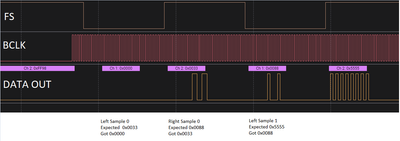

As a test, I have written specific values (0x0033 , 0x0088) to the first to the first two int_16 of the output buffer. And I expect to see the first sample output with FS low, then then next with FS high. However checking the data output with a logic analyzer, shows that 1. There is an initial sample that is 0, which is not in the output buffer. 2. The left and right data are swapped.
I've tried changing the FS polarity, which will fix the transmitted samples, but then the received samples are swapped.
I guess it could be possible to change the FS polarity only for the TX SAI sub-block, but ideally there shouldn't be this issue in the first place.
