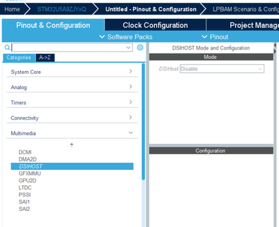

I am designing a board based on the STM32U5A9ZJxQ and I would like to use MIPI as the video output.
On stm32 cube IDE it does not show the peripheral to enable it.
Is is some kind of bug? Shouldnt be there?
Thank you

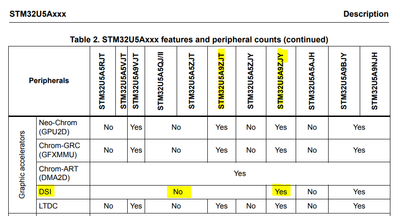

Hello @Avgerinos ,
Which STM32U5A9ZJ are you using?
The DSI is available in STM32U5A9ZJY  but is not available in STM32U5A9ZJT.
Fore more in formation I advise you to refer to the datasheet
Could you please try with the latest versions of STM32Cube MX and STM32CubeIDE.
Thank you.
Kaouthar

Hello
I am using the STM32U5A9ZJT.
So it is only available in bga packages.
I chose the STM32U5A9ZJT to have a simpler PCB design, but also i can not find in stock the STM32U5A9ZJY  and the other bga packages.

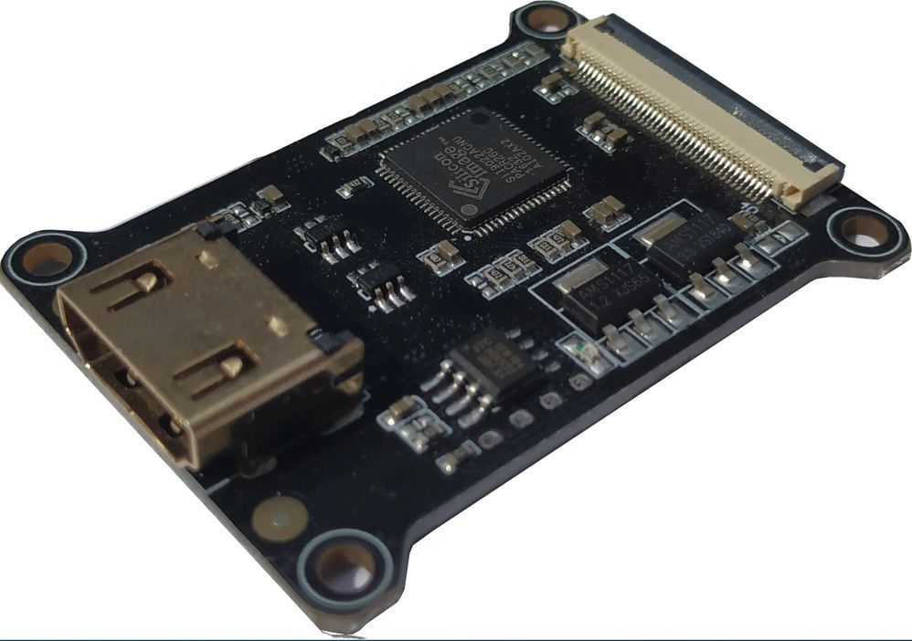

>>I could not find any ic that converts RGB LCD to HDMI
Silicon Image SII9022A/9024A
https://www.digikey.com/en/products/detail/lattice-semiconductor-corporation/SII9022ACNU/6596625
https://datasheet.ciiva.com/26836/getdatasheetpartid-368235-26836796.pdf
This is great!!!
Thank you for your help! :)
For proto-type / testing
https://www.aliexpress.us/item/3256804035123554.html
